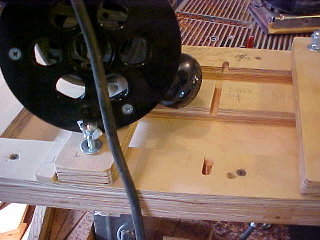

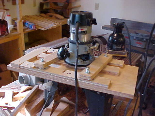

I emailed Bruce, here is what he sent me
Hi Rod,
I've been fine. Working out of town some, now back in the shop. Yes, I copied my x-brace from an idea I saw on Hoffman's site. Mine and his are totally different looking though. Mine cut's fourteen braces at once with a 5/16th in carbide bit. The first and last brace are sacrificed in the process, so I sometimes put scrap in those positions. The rest back each other up and cut perfectly.
You know you have a great fit when it makes a little squeak as the x goes together. Then I hit all four joints with some thin CA and that is that, time for final arch sanding in the dish. Here are a few pics:

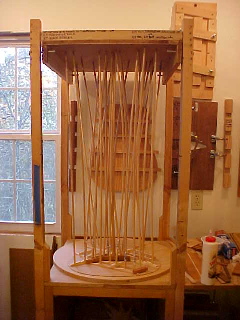

Here it is hanging behind my adjustable go-bar deck. The go-bar even angles to the taper of a guitar end to end, same sticks on everything, gluing braces, gluing top and back too, even my florentine jig uses the same sticks, 5/16 inch hardwood, plenty strong and resilient.
Back to the xbrace notching jig, the wingnuts under the cross bars, tighten the blanks into place. The underside of the cross bars is covered in cork for blank gripping. One pass, that's it. The first photo shows a plywood deadman which is used if only doing a few pair, just to take up space and give the router something to ride across. Pull the router toward you, and the closed end is on the left. I tried it to the right and it spewed braces all over the shop, out the open end. That was before the cork too. Jigs get better after you use them the first time. grin. Let me know if you have any questions. I still add a small piece of scab atop the open xbrace. Just makes sense to close it, Bruce
Rod True38650.0438657407

I'm confused, how it it adjustable? Looks to me like they all line up against the registered side and are clamped down in that postition. Am I missing something?
PostPosted: Tue Oct 25, 2005 12:11 am
Now that I look at it you are probably right.
However on mine, I am going to route a keyhole slot in that back clamp down area, so the whole parallogram will pivot left/right allowing you to change the angle. I may also need to add a top brace and change the way the back clamp down bolts work (slot vs. hole)
Then when you have it where you want it you can lock it down with the wingnuts. Brock Poling38650.3848726852
